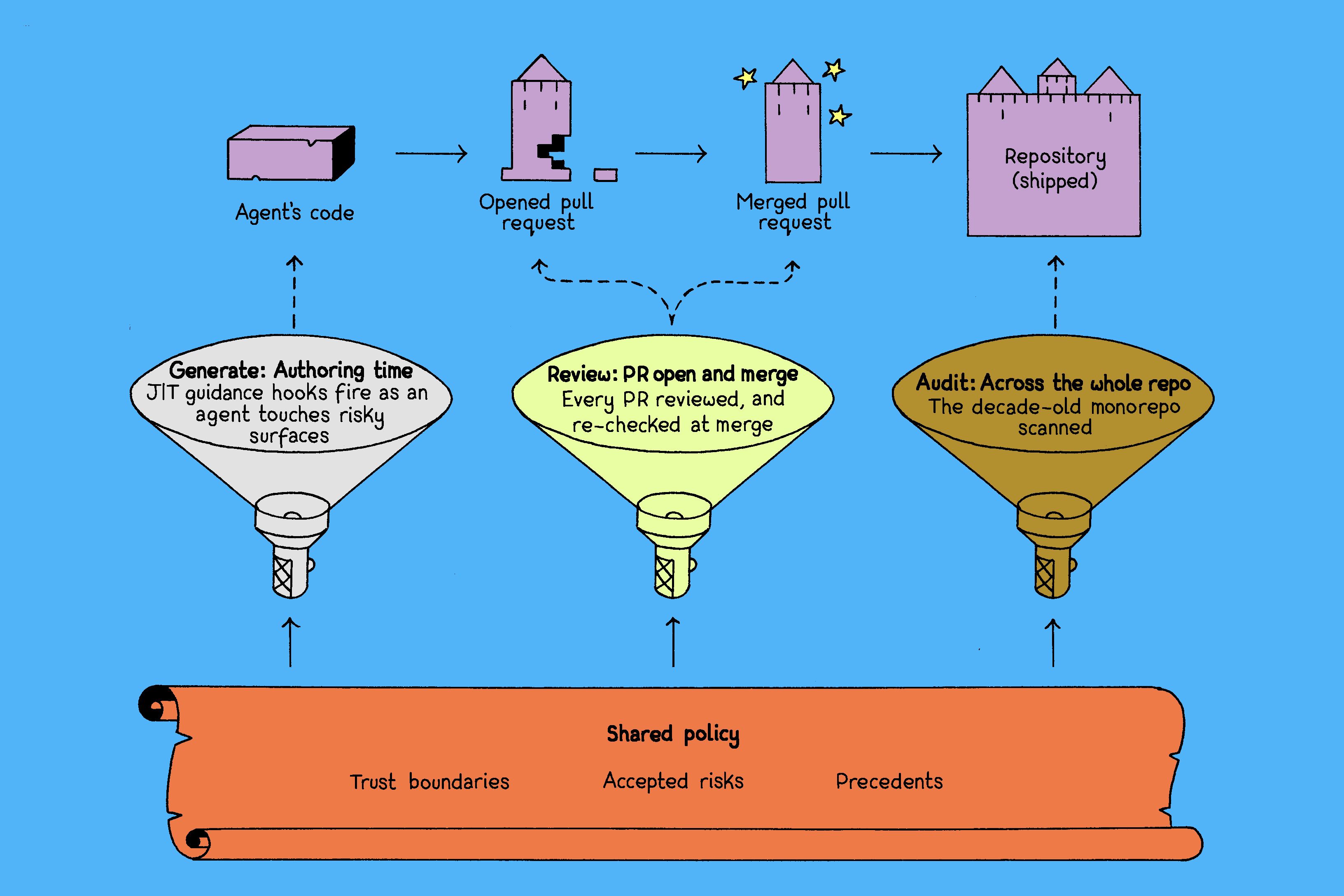

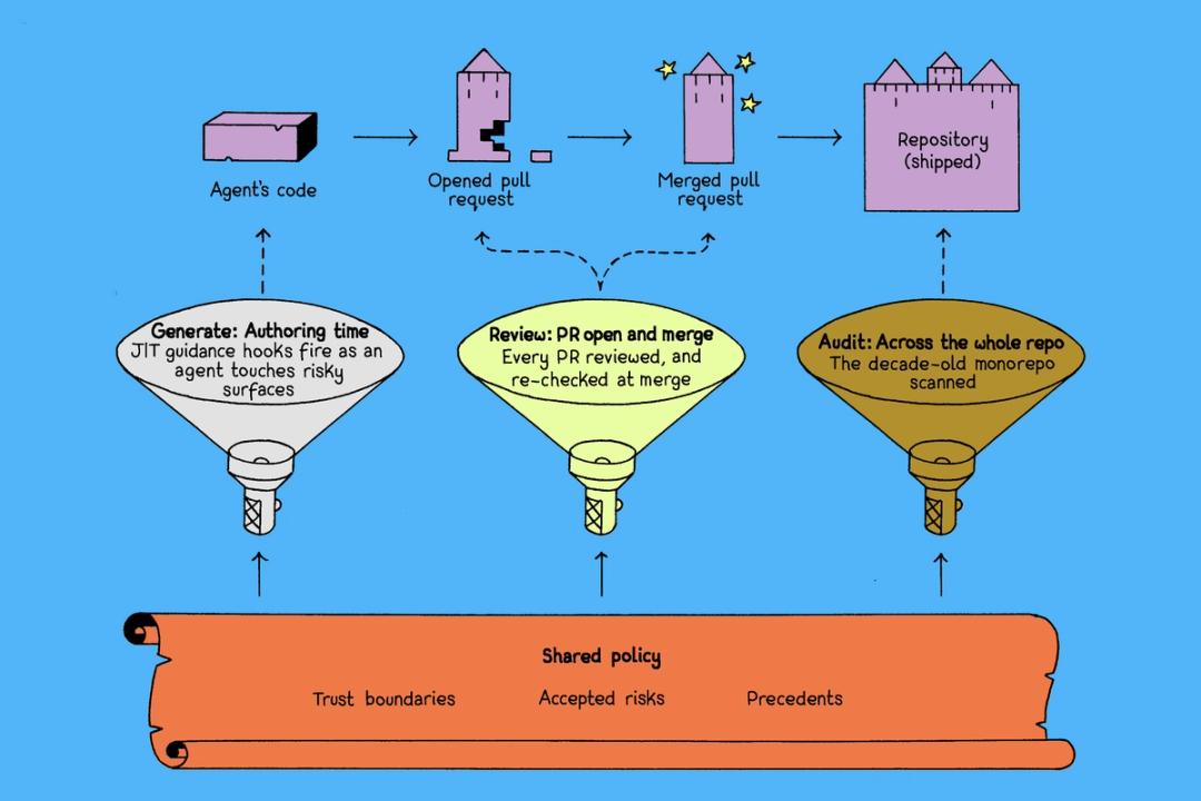

Software delivery pipeline with layered security: A shared policy powers AI checks during code authoring, pull request review, and full-repository audits before software ships.Software delivery pipeline with layered security: A shared policy powers AI checks during code authoring, pull request review, and full-repository audits before software ships.
Generation, review, and auditing all apply the same shared policy that contains trust boundaries, accepted risks, and precedents.

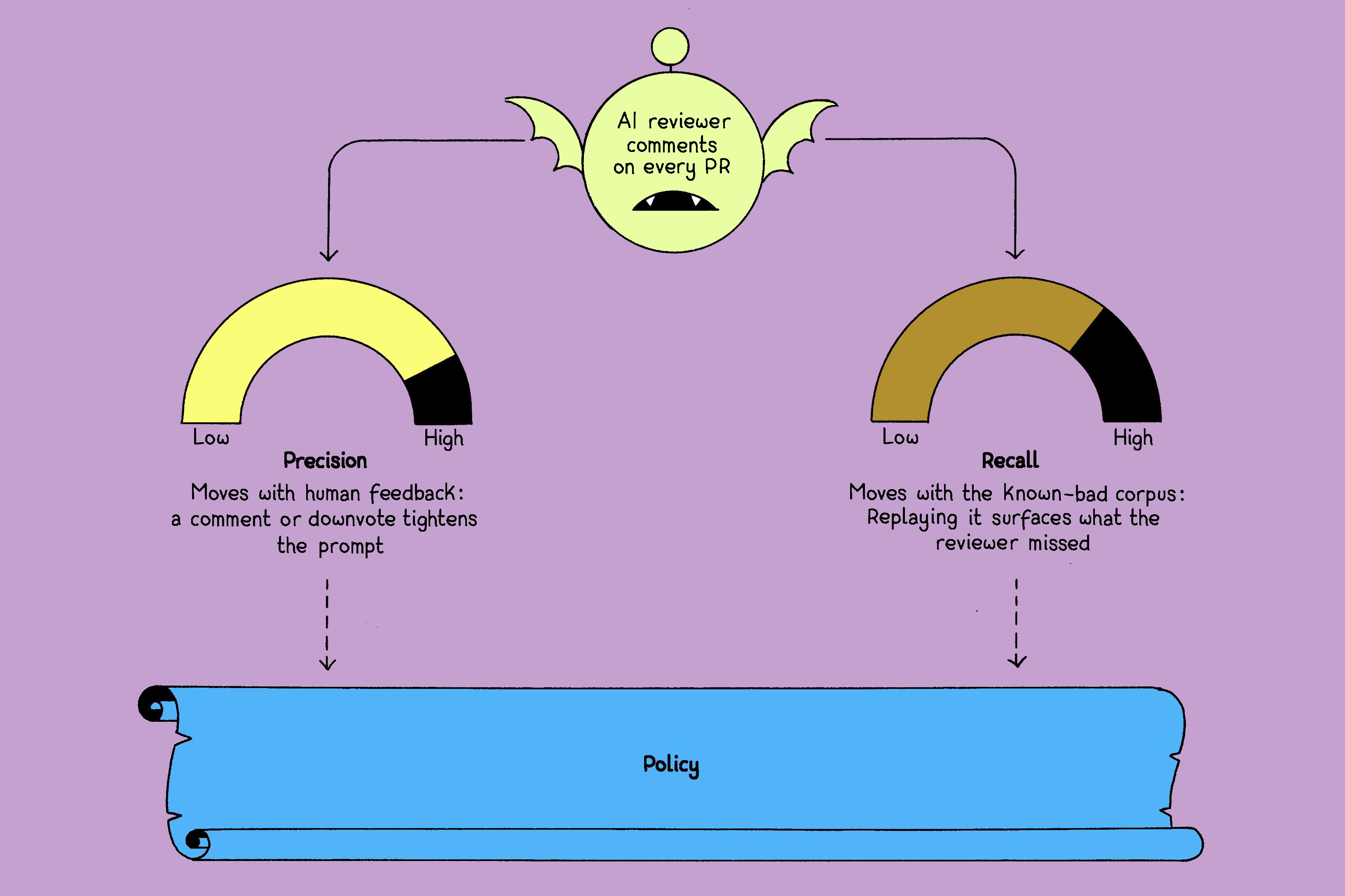

  3. It's instrumented in both directions: Precision and recall each get their own signal.
The precision signal is the author's rating: On the few PRs that surface a finding, the author gives it a thumbs up or thumbs down, usually with a note on why. To measure recall, we run the reviewer against commits we already know were buggy and count what it misses.
Improving an AI code reviewer: Human feedback increases precision while replaying known-bad examples improves recall, with both feeding back into a common security policy.Improving an AI code reviewer: Human feedback increases precision while replaying known-bad examples improves recall, with both feeding back into a common security policy.

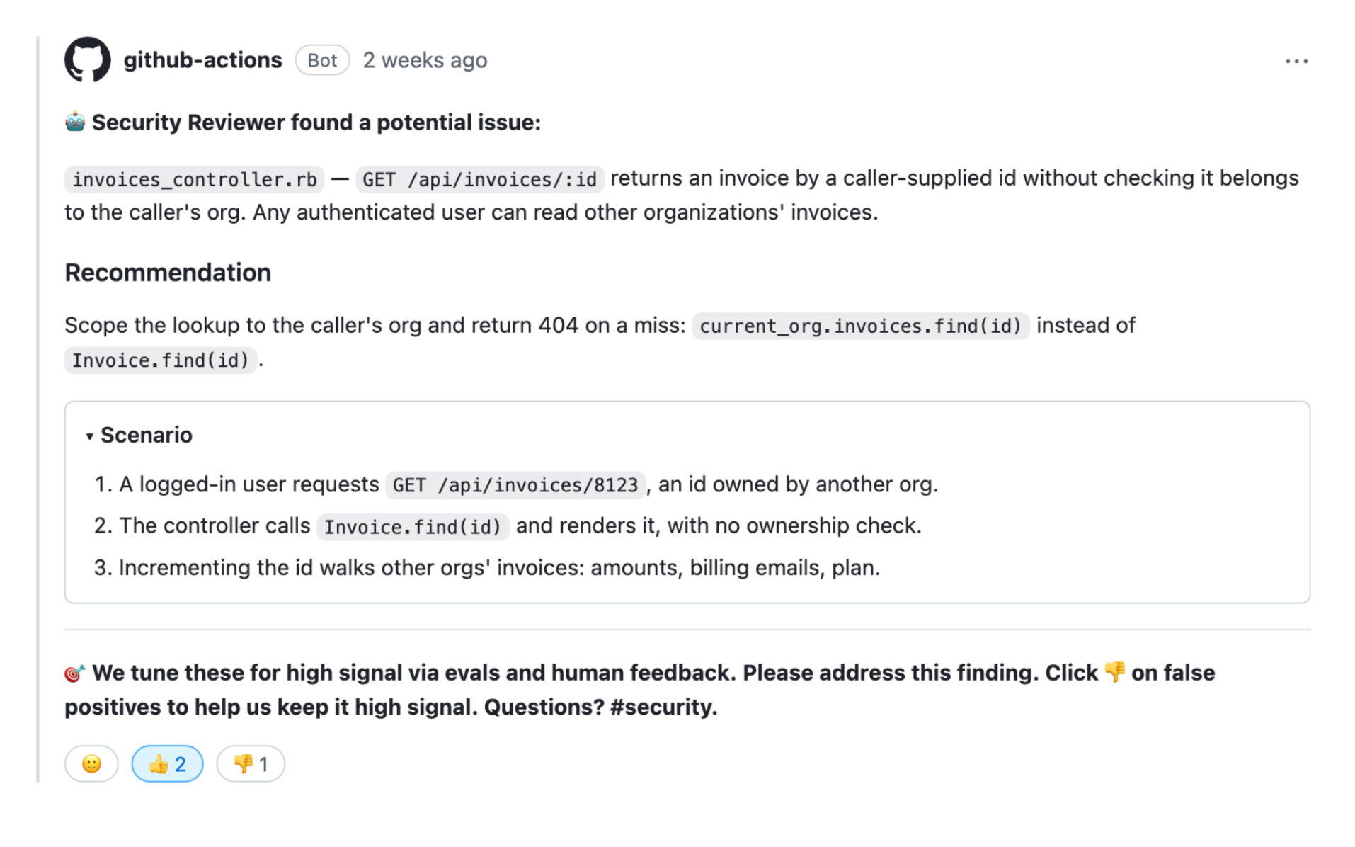

Some of the vulnerabilities our reviewer catches involve complex multi-step chains. On one recent PR, it reasoned that an injected sandbox object leaked the host realm's Function constructor, opening a path to code execution in the desktop client.
Most of what it catches is more ordinary, and still worth fixing. For example, on another recent PR, the reviewer flagged an endpoint that returned an invoice by a caller-supplied ID without checking if the invoice belonged to the caller's org—meaning that any authenticated user could read another organization's invoices just by knowing the ID. Here’s a very simplified version of the finding:
AI security reviewer comment on a GitHub pull request identifying an insecure object reference and recommending scoping invoice lookups to the authenticated user's organization.AI security reviewer comment on a GitHub pull request identifying an insecure object reference and recommending scoping invoice lookups to the authenticated user's organization.

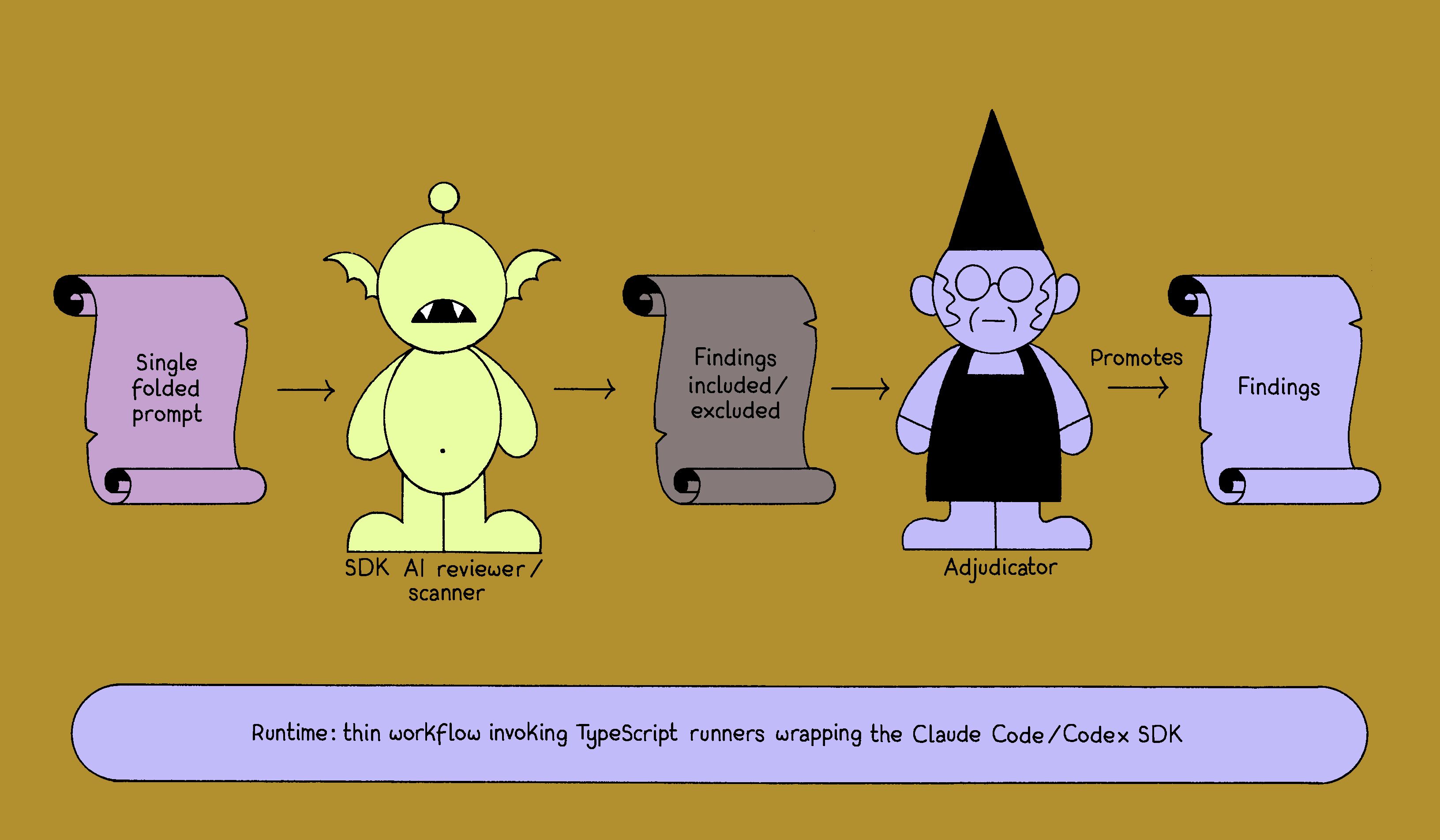

  • Added an adjudicator. The reviewer kept missing real bugs, and from analyzing eval data we kept seeing the same pattern: Chasing precision, the agent talked itself out of true findings with "pre-existing pattern," "low confidence," or "preparatory plumbing." The first pass already emits the candidates it dropped as structured output, so we added a second pass that re-examines those borderline dismissals. In our evals with known-bad commits, adjudication raised pass-rate recall by a relative ~30%.
AI review workflow: A single prompt drives an AI reviewer that proposes findings, which a human adjudicator filters before promoting approved results.AI review workflow: A single prompt drives an AI reviewer that proposes findings, which a human adjudicator filters before promoting approved results.

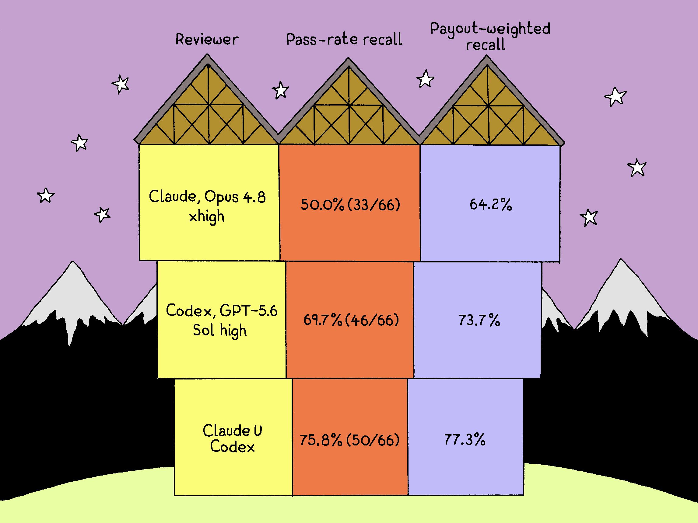

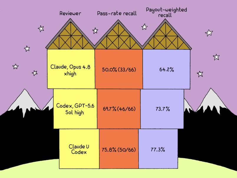

Reviewer benchmark comparison: A chart compares three AI reviewers by pass-rate recall and payout-weighted recall, with later systems outperforming earlier ones.Reviewer benchmark comparison: A chart compares three AI reviewers by pass-rate recall and payout-weighted recall, with later systems outperforming earlier ones.
Every policy change is reviewed by a security engineer and rerun against the full corpus before it ships. That catches regressions on the bugs we already know about; it tells us nothing about the ones we haven’t found yet.
What the policy is worth
To see what the engineering is worth versus the raw model, we ran the same Claude Code reviewer with our entire Figma policy ablated to nothing: just "find vulnerabilities," the model, and tools. It still cleared 44.4% of the corpus on payout weight.
While a frontier model finds plenty of vulnerabilities with no help at all, our policy is still a significant advantage. With our policy back in, the same single reviewer climbs from 44.4% to 64.2%. Precision is the larger gap: With no exclusions to lean on, the empty prompt flags every suspicious pattern. We can’t put a number on that from this run, because the corpus is all true positives and only measures recall, but anyone who has turned a coding agent loose on their own repo has seen exactly this.

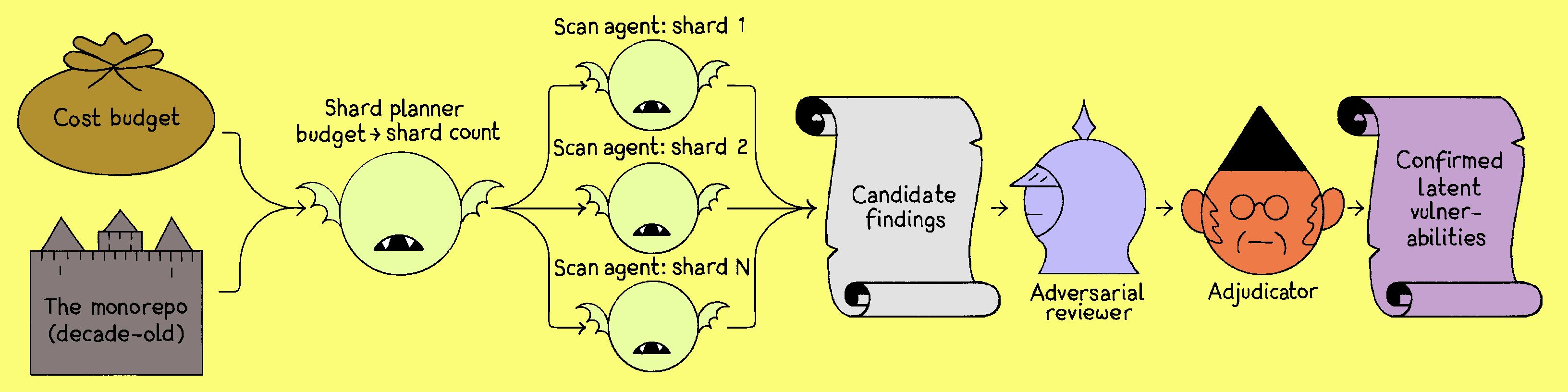

We made the task tractable by brute-forcing the problem with many agents. We picked a cost budget and, knowing roughly what one agent costs to scan one slice, turned it into an agent shard count, then scanned. We mostly shard by file or by application routes. Two more adjustments helped: ablating low-severity bug classes so the budget goes where it matters, and bringing back a lightweight adversarial review pass to refute findings.
Large-scale repository scanning: A budget-aware planner splits a monorepo into shards for parallel AI scanning, then adversarial review and human adjudication confirm vulnerabilities.Large-scale repository scanning: A budget-aware planner splits a monorepo into shards for parallel AI scanning, then adversarial review and human adjudication confirm vulnerabilities.
On our first run, we found more than a hundred latent vulnerabilities, including two criticals missed by traditional SAST tools, which we patched immediately. We added both to our eval corpus, where they are now its two highest-scored tasks.

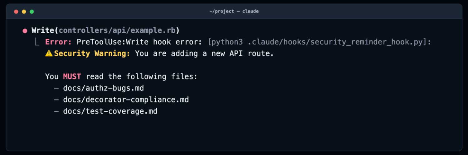

An agent hook is a script that runs automatically at a defined point in an agent's loop: before or after a tool call, after a user prompt, at session start, etc. These are like git hooks, but instead of firing on git operations they fire on the agent's actions, letting you inspect, block, or modify what the agent does.
To help agents generate secure code, we use hooks. We've found they steer agents more reliably than the same guidance placed in AGENTS.md. For some bug classes like logging safety (writing data to the wrong logs), the drop after we added a guidance hook was about 50%. We maintain a vendored, agent-agnostic version of Anthropic’s security guidance plugin. It has two sets of agent hooks:
Terminal showing an AI coding assistant blocking a file write with a security warning that requires reading authentication, compliance, and test coverage documentation before adding a new API route.Terminal showing an AI coding assistant blocking a file write with a security warning that requires reading authentication, compliance, and test coverage documentation before adding a new API route.
Adapted recreation (not a live terminal capture). The just-in-time PreToolUse hook intercepts a Claude Code Write, detects the new API route rule, and blocks the edit until the agent reads the required API route and authorization guidance. Note that the above guidance is for the agent, not the human operator.
Hooks also have a property that PR review doesn’t: They don’t carry a high precision bar, because they’re mostly invisible to the human author. That lets us use them to nudge toward good practices, not just away from vulnerabilities. When an agent adds a new API route, a hook can steer it to attach the proper secure-by-default authorization decorator and tests, in addition to merely surfacing authorization bugs.
