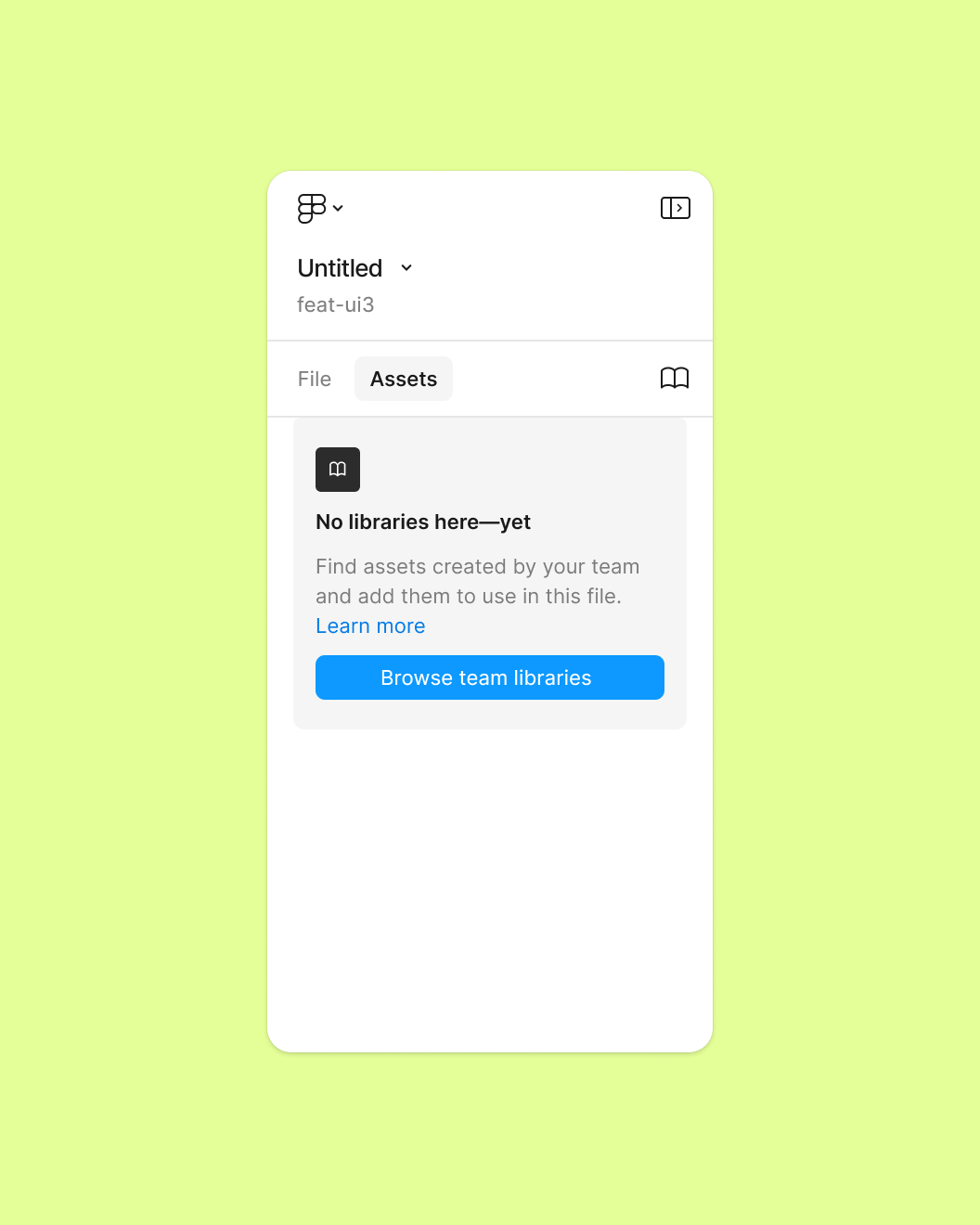

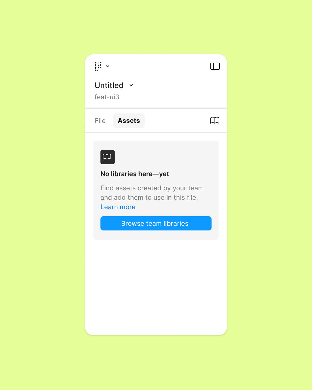

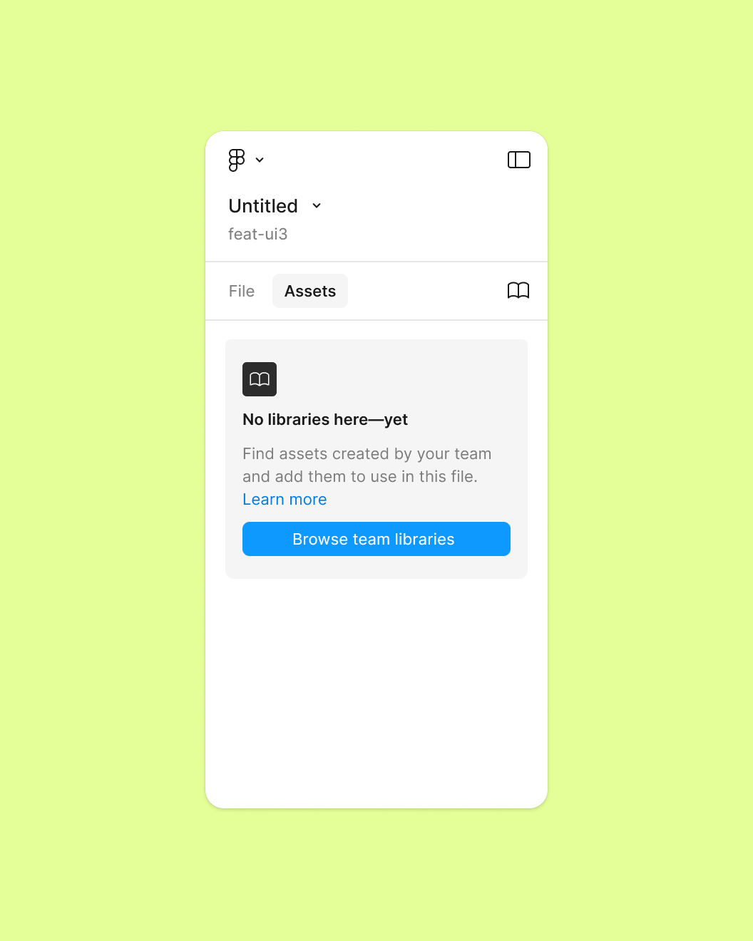

Figma's Assets panel displaying the design state used as the Code Connect example, with no team libraries available.Figma's Assets panel displaying the design state used as the Code Connect example, with no team libraries available.
Figma design

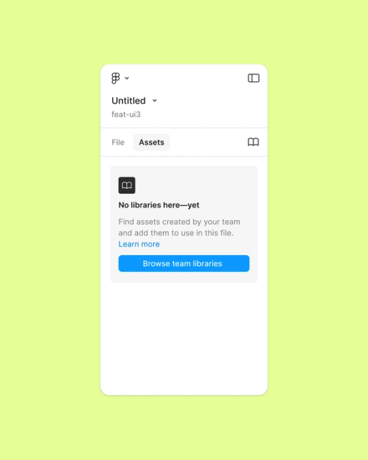

Figma's Assets panel without the Code Connect indicator, showing an empty state with no team libraries available.Figma's Assets panel without the Code Connect indicator, showing an empty state with no team libraries available.
UI using Figma’s MCP with no Code Connect

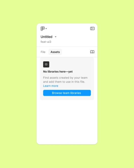

Figma's Assets panel showing the Code Connect indicator, signaling that code-connected components are available.Figma's Assets panel showing the Code Connect indicator, signaling that code-connected components are available.
UI using Figma’s MCP with Code Connect
The code quality results are just as interesting. Without Code Connect, the coding agent hand-built the tabs and buttons as raw React code and CSS. Even though it looks visually close, it’s not even functional—the tabs aren’t interactive, but instead hardcoded to look like the designs, including the selected state! Also, note the slight differences between icons and padding, details that are critical to a high-quality product; the runs with Code Connect got much closer to the original.
Here is an example code snippet from the result without Code Connect:
TypeScript
{/* Plain divs for the tabs */}
<div className="lv-tabs">
  <div className="lv-tab lv-tab-inactive"><span className="lv-tab-text-inactive">File</span></div>
  <div className="lv-tab lv-tab-active"><span className="lv-tab-text-active">Assets</span></div>
</div>
{/* Raw button element */}
<button className="lv-browse-btn">
  <span className="lv-browse-btn-text">Browse team libraries</span>
</button>
/* CSS: ~300 more lines*/
.lv-tab { display: flex; align-items: center; gap: 4px; height: 24px; padding: 0 8px; border-radius: var(--radius-medium, 5px); }
.lv-tab-inactive { background: var(--color-bg, white); }
With Code Connect, the coding agent correctly imported and used design system components, producing more succinct, higher-quality code:
TypeScript
{/* Usage of the FPL tab component */}
const [tabPropsMap, tabPanelPropsMap, tabManager] = Tabs.useTabs<'firstTab' | 'secondTab'>(
  { firstTab: true, secondTab: true },
  { defaultActive: 'secondTab' },
<Tabs.TabStrip manager={tabManager}>
  <Tabs.Tab {...tabPropsMap.firstTab}>File</Tabs.Tab>
  <Tabs.Tab {...tabPropsMap.secondTab}>Assets</Tabs.Tab>
</Tabs.TabStrip>
{/* Usage of the FPL Button component */}
<Button variant="primary" width="fill" onClick={() => {}}>
</Button>
